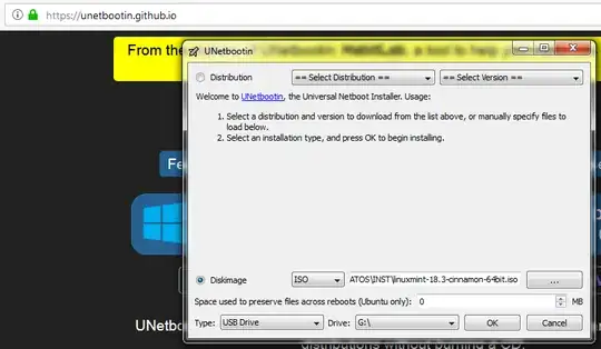

  • Create the bootable USB using unetbootin - https://unetbootin.github.io/ making sure you disable (set to 0) the local file storage for any Linux distro that is not UBUNTU
UNetBootIn options In my case it seems that the .ISO file was corrupt, I downloaded it again in another computer, checked the integrity and follow the steps above and I have now a booting USB that will allow me to fix/reinstall my laptop
