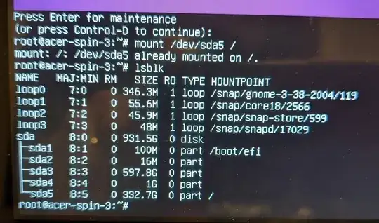

I have tried several times to boot in recovery mode but I do not get anywhere. I have managed to get the lsblk information from the commend prompt (root from the Recovery menu) and it looks as follows:
lsblk from command prompt
I believe the sda3 partition is the Windows partition while the sda5 is the Ubuntu partition. However, once in the command prompt I the only folders I see is are:
.cache
.local
snap
I do not seem to see my fodlers there.
