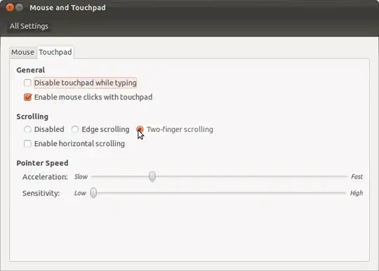

Did you try to open "System Settings"
and click on "Mouse and Touchpad", then select the "Touchpad" tab
and there select "Two Finger scrolling" and possibly "Enable horizontal schrolling"?

if someone still looking for the solution so:
open "System Settings" then click on "Mouse and Touchpad", then select the "Touchpad" tab
and there deselect "Two Finger scrolling"
and if you want normal scrolling so deselect either the "natrual scrolling"
(enable it just if you want a scroll like apple).
