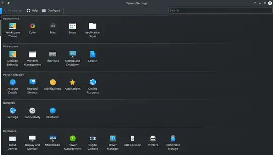

Edit 4: System Settings Network Tab Network Tab
