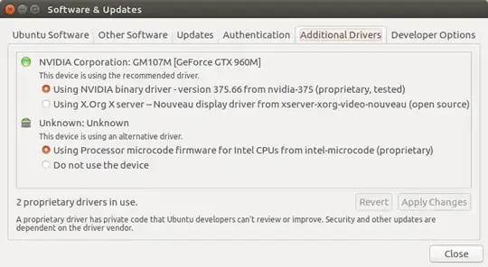

It seems like the system has successfully installed the nvidia proprietary driver as shown in the below image
driver installed

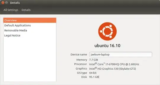

However it seems like the system is not using the graphic card.

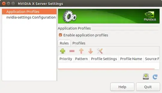

BTW, there should be some way to configure to use graphic card on nvidia-x server settings but it is not showing up on my machine.
Also, the output of glxinfo clearly shows that my system is not utilizing the nvidia graphic card.
jaebum@jaebum-laptop:~$ glxinfo | grep renderer
    GLX_MESA_multithread_makecurrent, GLX_MESA_query_renderer,
Extended renderer info (GLX_MESA_query_renderer):
OpenGL renderer string: Mesa DRI Intel(R) HD Graphics 530 (Skylake GT2)
