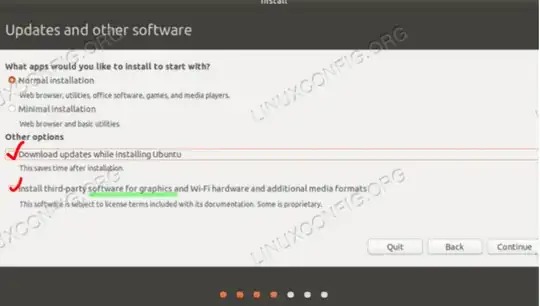

I had the same problem & it's caused by Nvidia graphics.
Did you install " third party software " in OS installation ?
You can try to delete your not recognized graphics, but more easy is a fresh new OS installation and let system choose right drivers. Install via sudo apt install ubuntu-restricted-extras , however if it won't enough to completely purge files and paths, much easy is reinstall OS. Nothing other works for me. Feel free to choose Normal or Minimal installation in first step of this window.

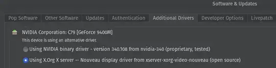

How annoying it is if the brightness control doesn't work? Pretty annoying! There's a simple solution, which I tried and worked out well.
Go to 'Software & Updates' --> choose 'Additional Drivers' there you can find NVIDA Corporation binary driver and below that open source. You have to choose the open source. Ta-da!
screenshot of Additional Drivers in Software & Updates
