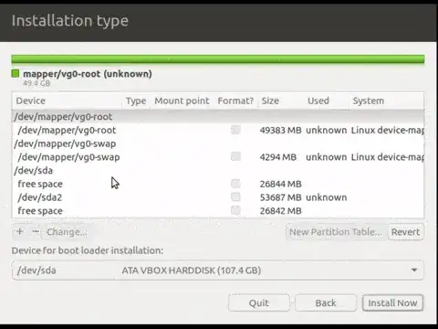

Run the installer from the live OS to begin installation. When you get to the section titled Installation type select the something else option
Then you assign mount points to the logical volumes we created so that Ubuntu can install the system.
