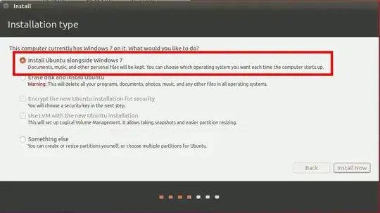

  • With your disk resized, go ahead and boot into your 16.04 live OS and start installation.
  • When you come to the section for "Installation type" the installer should see the unpartitioned space and offer to allow you to install alongside Windows 7. Select that option, and Ubuntu will automatically install to the unpartitioned space. 01.png
