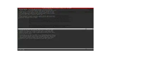

If you like to view the two files tiled horizontally, use
vi -o /home/rs/rest.pl /home/dev/grd.pl
