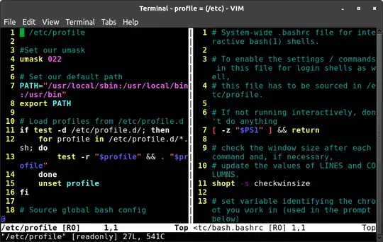

You can also use tabs and split views:
:tabe /path/to/file
Effect: enter image description here
:vs /path/to/file
(or :sp for a horizontal split)
Use :tabn, :tabp to navigate between tabs, and CtrlW with the arrow keys to navigate between splits.
