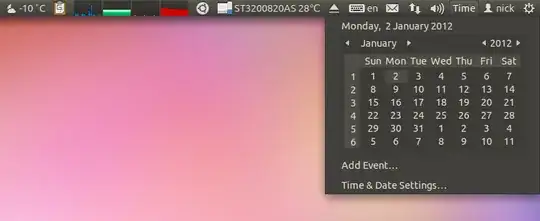

Yesterday I noticed that time indicator on the top pane is not showing the date/time, but is just saying "Time" (see attached screenshot). Does anyone know why is that so? How can I fix it and make show the date/time back again?

It's likely that the indicator is misconfigured.
Try to click Time & Date settings in your screenshot, in the next window choose clock and play with those settings.
If this doesn't work try this command, it will change the potenciall most complicated of your clock settings to the defaults:
gsettings set com.canonical.indicator.datetime time-format locale-default

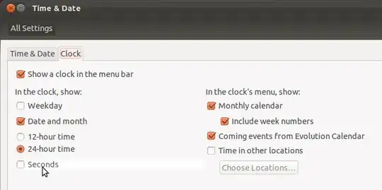

Can I suggest you right click the click and choose Time & Date Settings
Check that you have a valid location set (the field and the graphic point to your country and capital city etc).
Also check the next tab that the defaults are defined as per this image:
