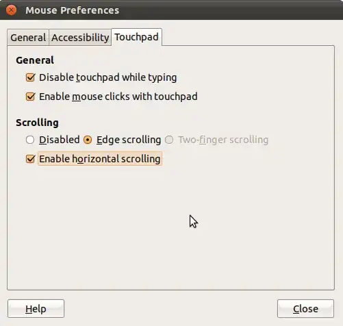

Your touchpad (hardware) needs to support this feature and you then may need to configure your touchpad (Ubuntu automatically recognizes and enables some hardware).
One common drier is synaptic. You can enable two finger scrolling from the mouse and touchpad section in the control panel.
control panel
If you wish additional options you will need to manually edit a few configuration files and the options are hardware dependent.
