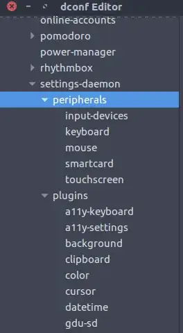

I want to switch between workspaces on my Ubuntu 16.04LTS with a swipe on my touch pad. I read some questions and answers here to find a solution before asking. but there is no horizontal scrolling option like in this answer and no touchpad listed in dconf editor like in this answer. Now I can use my touchpad to two finger vertical scrolling. What is the problem with my touchpad? Is it not recognized correctly?

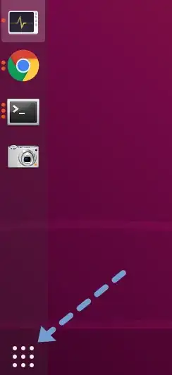

"Show Applications" icon
Place the mouse pointer over the "Show Applications" icon at botttom left of screen and then do :
  • 2-finger swipe Up/Down on touchpad OR
  • scroll the mouse wheel up/down
That would switch you up/down between your desktops.

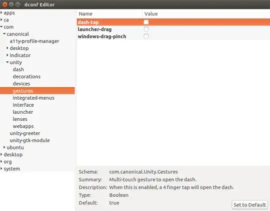

You will also need to disable the built in multi finger gestures that come with the Unity desktop. Credit where it's due - this answer from another post recommends installing the dconf-editor package and disabling the gestures using the GUI.
sudo apt-get install dconf-editor
dconf-editor
dconf-editor settings
