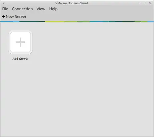

Starting the vmware-view command gave me exactly the same error. Using Google I found I had to run this command:
wget http://mirrors.kernel.org/ubuntu/pool/main/u/udev/libudev0_175-0ubuntu9_amd64.deb
Then I used File Manager in the directory to right-click the downloaded file and let Software Installer do its thing.
Then I gave the command 'vmware-view' and got:
