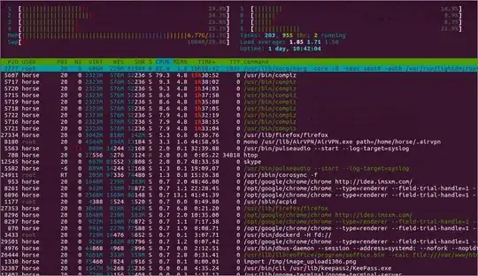

I see htop gives a lot more options than top, so its probably a better tool for diagnosing the issue. Theres a few things I don't understand about all this, firstly which is more important %CPU or %MEM when it comes to your computer freezing regularly. htop allows you to sort by either one, heres what it shows me when I sort by memory usage:enter image description here

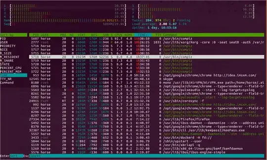

and heres what I get when I sort by CPU usage:enter image description here
So like I saw from running ps, firefox and chrome are taking up most of the memory, and compiz is taking up most of the CPU. Are there any other important factors to look at when it comes to unfreezing your system? For example, does the length of time a process has been running for come into play, I see compiz has been running longer than anything else:enter image description here

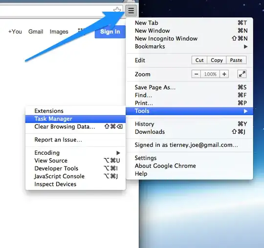

Your bottleneck is whatever appears maxed out in a task manager like htop. In this case, it appears to be RAM overflowing with Chrome tabs. Fortunately, Chrome comes with its own task manager that allows you to see and kill which tab is hogging your RAM:
Google Chrome Task Manager
Chrome extensions like The Great Suspender and Lazy Tabs also help save RAM.
