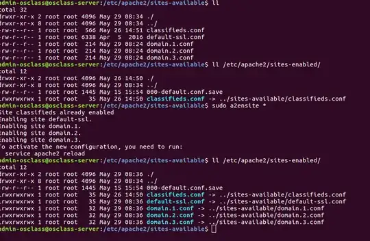

You need to navigate to /etc/apache2/sites-available and then run the command:
sudo a2ensite *
It will enable all sites in the directory. (the files should be somthing like xxx.conf)
And then reload apache using sudo service apache2 reload.
So your command sequence should be like so:
cd /etc/apache2/sites-available
sudo a2ensite *

Move the default configs to another folder and then the * should work for you as you want it to.
Go to the folder "sites-available" since it only works in this folder.
cd /etc/apache2/sites-available/
sudo a2ensite *
tested
