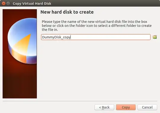

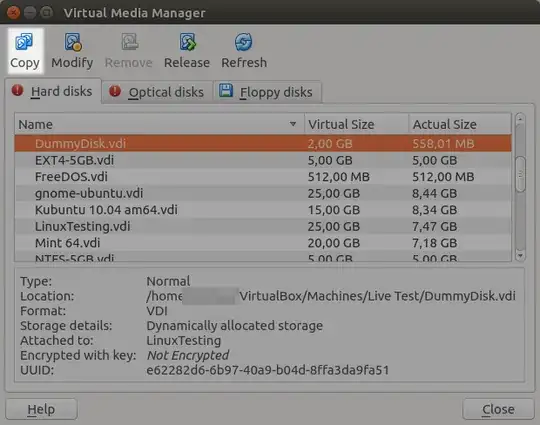

The recommended way to move a virtual machine to another location is by calling the Virtual Box Media Manager (Ctrl+D) and copy a virtual drive to another location:
Choose another path for the new hard drive when asked:
Then attach this drive to the existing VM.

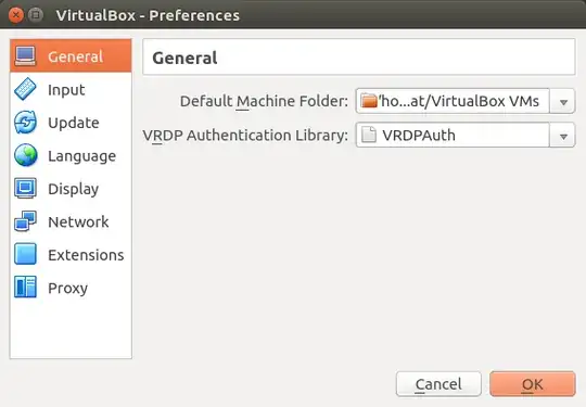

For new drives we can define the path Virtual Box stores them in the preferences (Ctrl+G):
