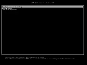

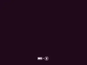

Identifying if the computer boots the CD in EFI mode
Warning: even if your PC boots the CD in EFI mode, it might boot the HDD in Legacy mode (and the contrary).
When booting on a 64-bit Ubuntu disk:
  • If the BIOS is set up to boot the CD in EFI mode, then you will see the screen below:
UEFI mode
  • If the BIOS is NOT set up to boot the CD in EFI mode, or if the disk is not 64-bit, then you will see the screen below:
BIOS mode
Be sure to use the same guide referred to in order to ensure hard drive is booted using UEFI also. This may be as simple as setting SATA to AHCI but depends on your firmware being used.
