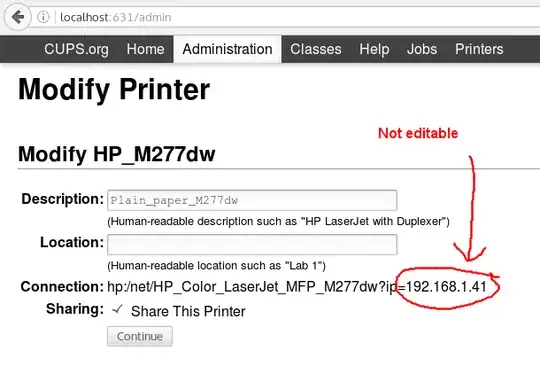

I have a network printer with a static IP address. Recently I've changed my subnet and had to allocate it a new static IP address.
I've tried to update CUPS with the new IP address by going to Printers -> [Printer name] -> Administration -> Modify printer -> Current connection -> Continue. I'm presented with this screen but the connection string is not an editable box, so I can't change the IP address:
CUPS screenshot
How can I modify the IP address?

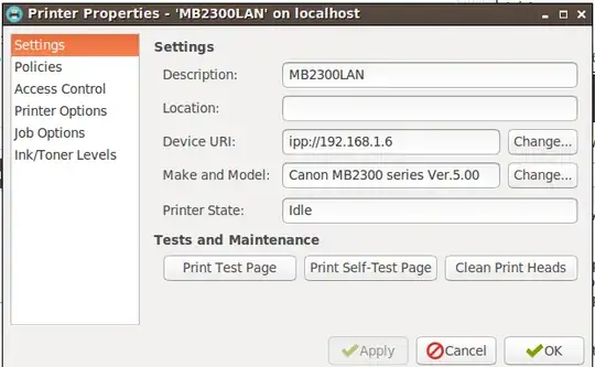

I've never had much joy from the CUPS web interface.
You can change the printer URL here, at least if your setup is similar to mine.
Preferences/Printers, right click and choose Properties
The IP address is not a modifiable field, because, if you changed it, it would describe a different printer.
Abandon the "Modify Printer" approach, and on http://localhost:631/admin, Find New Printer
