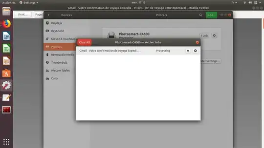

I have an old Photosmart C4500 and I want to print a page from Firefox on Ubuntu16.04. Yet the printer is stuck at processing status. I can still cancel the task but and relaunch it but it remains stuck. I also removed and reinstalled the printer but it doesn't changed anything. It doesn't seems the printer actually receive data.
Do you have any idea on how to make this work ?
I clicked on additional printer settings and was either able to add a new printer enter image description here
Or to troubleshoot but it told me that "there is no obvious solution to your problem". Furthermore I wasn't able to log its report as far as it doesn't accept my password.
