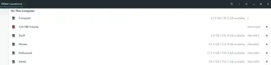

I've a lot of partitions named loop they're likely created by a snap app called Anbox, I could care less about lopp0 to loop4 but the partition named loop5 which is mounted at /media/sumeet/disk appears in nautilus
Nautilus screenshot 326mb volume is the loop partition is question
when I opened this partition I found that I don't have the permission to open most of the folders inside it.

How can I hide loop5 from being visible in nautilus?
LiveWireBT
  • 29,597
11
The easiest way to do this would be to do it with GUI
  • Go to disk app (through Unity Dash or terminal with gnome-disks command)
  • Choose your partition (that would be loop5)
  • Click the little gear icon Gear icon
  • Select Edit mount options
  • Toggle Show in User Interface to Off
It'll stop showing the partition in Nautilus but will not affect Anbox in any way
