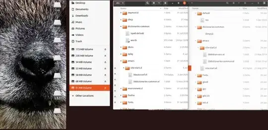

Today I accidentally removed python from my computer. I reversed some of the damage by reinstalling the purged packages according to a .log file. However, after python was removed, six mysterious partitions appeared on my desktop. They are still there. The rest of the computer is back to normal.
two slightly different versions of /etc/default
What I Know: They are named disk, disk1, disk2... I am not the owner. They all have different contents, including things like an /etc/ folder. Upon investigation, these seeming duplicates have very different contents than their counterparts on my HD.
Some applications are missing as well. I installed one of them earlier today. I think they were all installed with snap rather than apt. I cannot see any other commonalities.
This is a pretty weird problem, yeah? I don't actually even know how to describe it. I am afraid to turn off my computer or unmount these drives, because I don't know what they are or if I need them.
