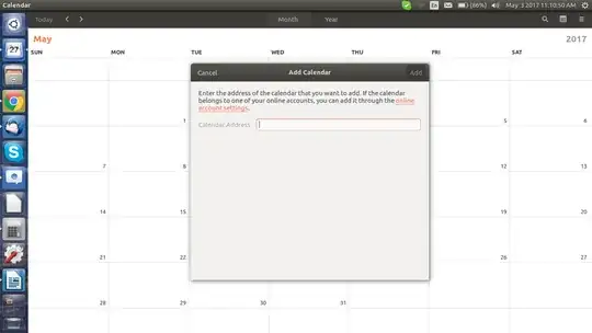

I thought it was awesome that Ubuntu 16.04 shipped with gnome-calendar, but I noticed that holidays were not included. I also noticed that there is an option to sync the calendar with an online one, how do I do this? I don't know of any online calendars I could use.

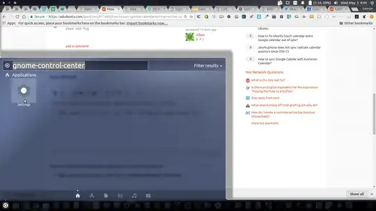

  1. Type gnome-control-center into dash, settings will appear select that and select online account:

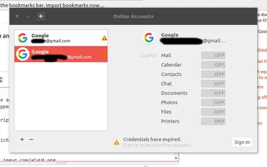

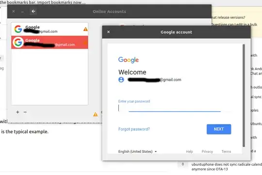

  2. Then add your google account by clicking the plus sign at the bottom of the dialogue window that appears:
    screenshot
  3. Then turn the calendar associated with that gmail account on, and this should sync it with Ubuntu Calendar.:

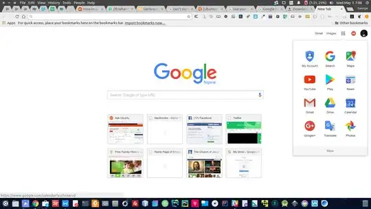

  1. Go to google calendar:
    screenshot

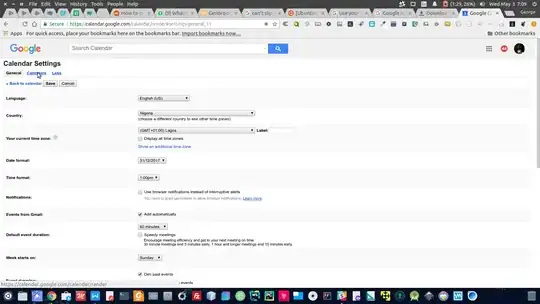

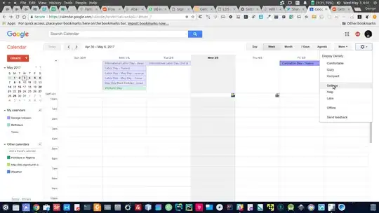

  2. Get to settings, top right of page:
    screenshot
  3. In ther click on the Calendars tab, top left of page:

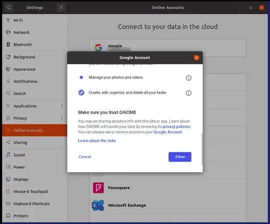

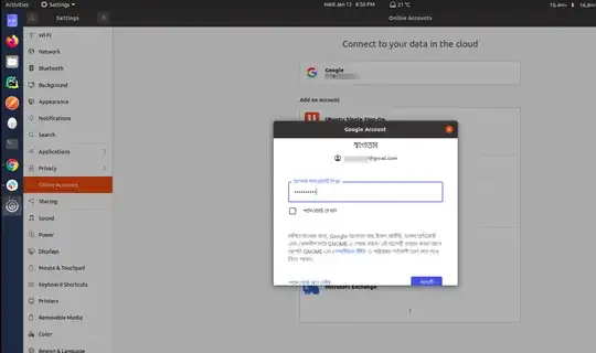

For Ubuntu 20.04, following these steps should enable syncing Google services.

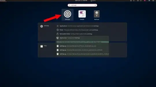

  1. Go to Settings from the Dash.

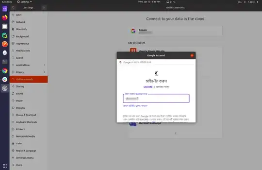

  2. From Online Accounts(1) select Google(2).
  3. Give your Username for Google account.
  4. Give your Password for Google account.
  5. Allow access on your Google account.
  6. Select what services you want to be synced.

For me, there was a bug with the gnome-calendar app where I could not click the "Add" button (the one in your screenshot), no matter what I entered.
