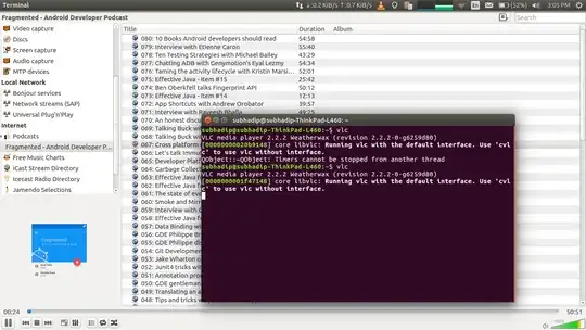

However, I am not able to start VLC without its GUI. I read here here some answers to this problem, but they did not work, for instance: vlc -I null does not work and vlc --intf dummy does not work either.
My VLC version is 2.2.2

Try
cvlc music.mp3
cvlc is the command-line interface of VLC media player
