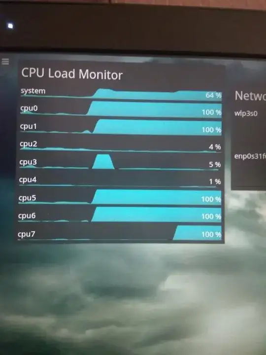

EDIT:
A screenshot when it freezes - as you can see that most of the CPUs are reaching 100%!
Why?? It never happened before!

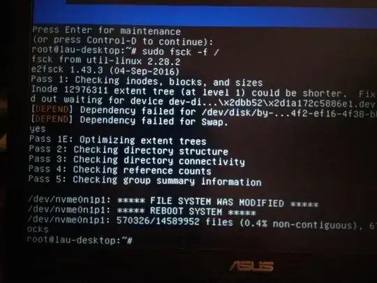

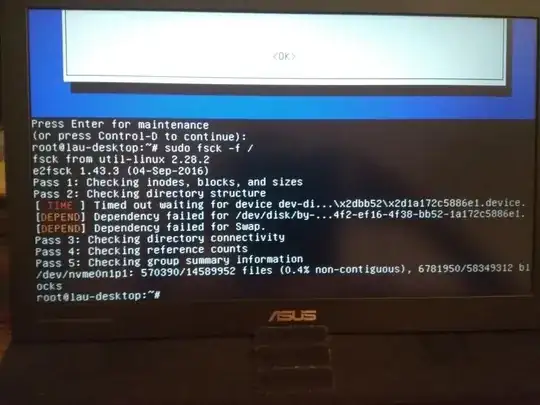

Edit 5:
Edit 6:
Logged in normally:
$ sudo blkid
/dev/nvme0n1: PTUUID="994f73a0" PTTYPE="dos"
/dev/nvme0n1p1: UUID="5d13e954-064d-4700-9ac9-ed3002a036f3" TYPE="ext4" PARTUUID="994f73a0-01"
/dev/nvme0n1p5: UUID="2910a4f2-ef16-4f38-bb52-1a172c5886e1" TYPE="swap" PARTUUID="994f73a0-05"
$ sudo cat /etc/fstab
# /etc/fstab: static file system information.
# Use 'blkid' to print the universally unique identifier for a
# device; this may be used with UUID= as a more robust way to name devices
# that works even if disks are added and removed. See fstab(5).
# <file system> <mount point>   <type>  <options>       <dump>  <pass>
# / was on /dev/nvme0n1p1 during installation
UUID=5d13e954-064d-4700-9ac9-ed3002a036f3 /               ext4    errors=remount-ro 0       1
# swap was on /dev/nvme0n1p5 during installation
UUID=2910a4f2-ef16-4f38-bb52-1a172c5886e1 none            swap    sw              0       0
Edit 7:
I have repeated the #1:
Then logged in to the terminal:
$ sudo blkid

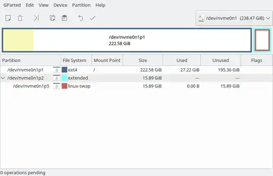

Edit 9:
$ sudo gparted
Created symlink /run/systemd/system/-.mount → /dev/null.
Created symlink /run/systemd/system/run-user-1000.mount → /dev/null.
Created symlink /run/systemd/system/run-user-119.mount → /dev/null.
Created symlink /run/systemd/system/tmp.mount → /dev/null.
(gpartedbin:3431): Gtk-WARNING **: Unable to locate theme engine in module_path: "adwaita",
libparted : 3.2
Removed /run/systemd/system/-.mount.
Removed /run/systemd/system/run-user-1000.mount.
Removed /run/systemd/system/run-user-119.mount.
Removed /run/systemd/system/tmp.mount.
Edit 10:
I did the #1:
and #2
$ sudo blkid
# UUID=2910a4f2-ef16-4f38-bb52-1a172c5886e1 none            swap    sw              0       0
$ sudo lsblk -f
NAME        FSTYPE LABEL UUID                                 MOUNTPOINT
nvme0n1
├─nvme0n1p1 ext4         5d13e954-064d-4700-9ac9-ed3002a036f3 /
├─nvme0n1p2
└─nvme0n1p5 swap         2910a4f2-ef16-4f38-bb52-1a172c5886e1
It still freezes as before though...

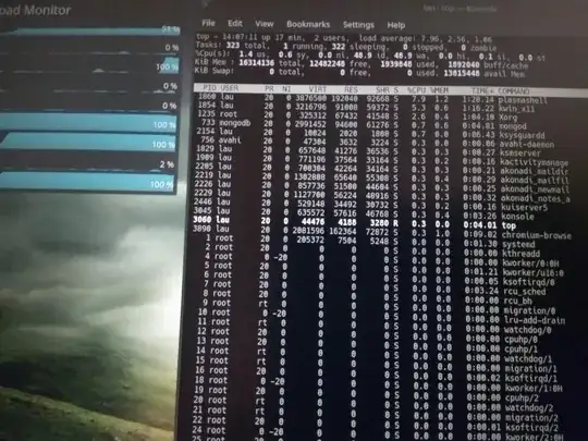

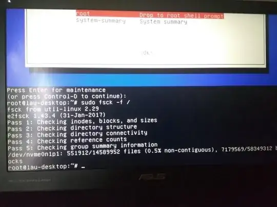

EDIT 11:
I captured the screenshot when it freezes with top on my terminal. I don't see anything is causing the freeze.
I have upgraded my Kubuntu/ Ubuntu to 17.04. Thought it might fix the issue but it doesn't...
EDIT 12:
$ sudo mkswap -L swap /dev/nvme0n1p5
mkswap: /dev/nvme0n1p5: warning: wiping old swap signature.
Setting up swapspace version 1, size = 15.9 GiB (17059278848 bytes)
LABEL=swap, UUID=d7210e00-cc66-42ca-96ce-5111d6481007
$ sudo blkid
/dev/nvme0n1p5: LABEL="swap" UUID="d7210e00-cc66-42ca-96ce-5111d6481007" TYPE="swap" PARTUUID="994f73a0-05"

Step #1
Lets first check your file system for errors.
To check the file system on your Ubuntu partition...
  • boot to the GRUB menu
  • choose Advanced Options
  • choose Recovery mode
  • choose Root access
  • at the # prompt, type sudo fsck -f /
  • repeat the fsck command if there were errors
  • type reboot
Step #2
Lets find out why fsck is complaining about swap devices...
In terminal...
  • type sudo blkid
  • type sudo cat /etc/fstab
  • type sudo lsblk -f
Update #1
Notice this line in the sudo blkid...
Notice these lines in the sudo cat /etc/fstab...
Notice that the UUID= number is the same. This will become important after we do a mkswap command to try and fix the swap partition. The existing UUID number will change, and we'll have to edit /etc/fstab to reflect the UUID change.
For right now, I want you to comment out the second line of the swap definition in /etc/fstab, by placing a # at the front of the line, so it looks like this... (gksudo gedit /etc/fstab)...
Then redo step #1 and lets see if the swap errors are gone.

Although it won't fix your freezing problem, we now need to get your swap partition running again. The swap partition was causing fsck error messages. And although the blkid UUID matches the /dev/nvme0n1p5 UUID (which is the most common cause of errors) the swap area must be corrupt in some way. We'll build a new swap, and come up with a new UUID for /dev/nvme0n1p5 in that process, and we'll edit that new UUID into /etc/fstab.
  • boot to Ubuntu normally
  • assure that you've got backups of your important stuff, just in case of a problem
  • in terminal...
    • sudo cp /etc/fstab /etc/fstab.bak # make a backup of fstab
    • sudo mkswap -L swap /dev/nvme0n1p5
    • copy the new UUID to the clipboard
    • gksudo gedit /etc/fstab
    • uncomment the second line of the swap definitions
    • replace the UUID with a paste from the clipboard (no quote marks)
    • save the file and quit gedit
    • sudo blkid
    • sudo cat /etc/fstab
    • as I instructed you earlier, make sure the UUID's match for /dev/nvme0n1p5
    • sudo swapon -a # to enable the new swap
    • if there are any errors with the swapon command, comment out that line in /etc/fstab again until we figure out what's wrong
    • reboot
  • Repeat step #1 and confirm no swap related errors
