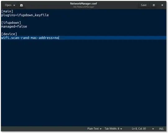

Your final results should look something like this: Configuration file to allow USB Wifi to work in Ubuntu 17.04
Then just save and close the file and run:
sudo service network-manager restart
And wifi should work again!
