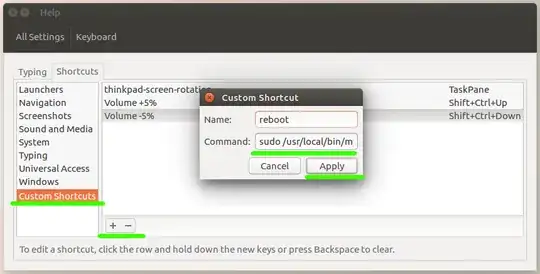

  3. Go to System SettingsKeyboardShortcuts (tab) → Custom Shortcuts (section) → Add new +.
    • In the Custom shortcut window type:
    • Name: reboot
    • Command: sudo /usr/local/bin/my_rbt
    • Click on Apply
  4. Click on Disabled in the right column and press the discussed button.
