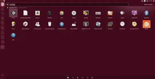

4. start Unity3d
Since most Desktops (I don't know which you are using) have a search function just search for "Unity". It should appear like here enter image description here

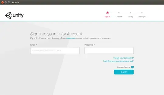

5. LogIn

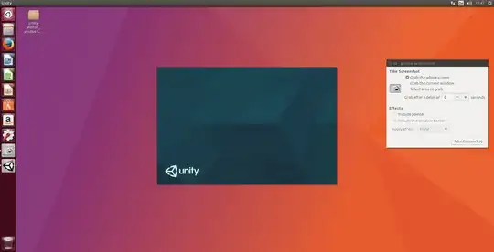

After the splash appears enter image description here
You will be asked to LogIn with you account data or to create one. enter image description here

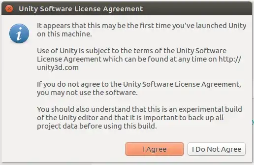

And respond the following question with I aggree ;) enter image description here

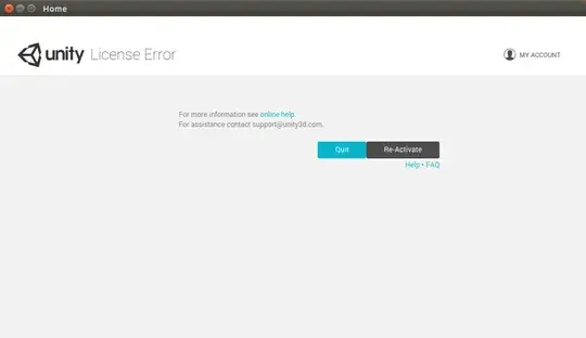

6. fix License-Error
It might happen (for me it did) that there is an Licence-Error coming up. Here click on "Re-Activate" on the right enter image description here

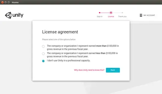

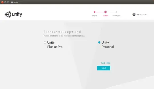

After this you have to choose your License Type (For example personal ;) ) enter image description here
And (though we said personal) responde the following (e.g. like this) enter image description here (Please be honest with this because developers of software also have to live from something ;) )

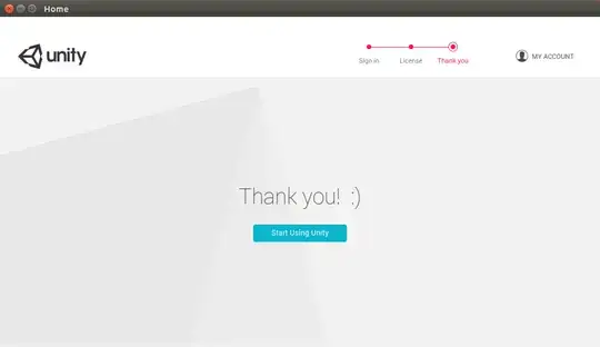

After finishing this step you should see this screen enter image description here

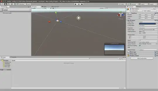

7. Use Unity
Create a new Project according to your needs and open it up. enter image description here
DONE :) You now should be able to use Unity on Ubuntu.
