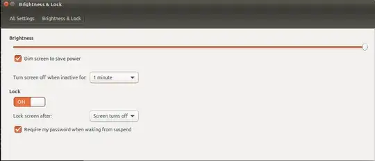

Recently I have noticed that the brightness and lock settings to turn off the screen after a period of inactivity are being ignored.
I have my settings at 1 minute and to lock the screen when the screen turns off but my computer never seems to turn the screen off.
I have seen similar questions where people are noting an issue where the screens turn back on and the lock screen is showing but I am not getting the computer to lock at all.
