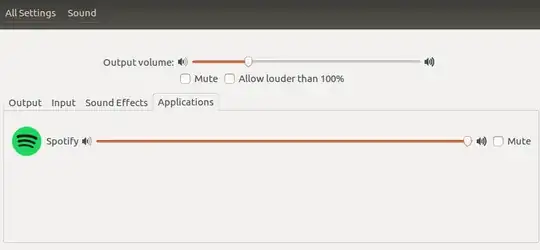

I found out just after I posted this. If you go to the "sound settings" menu and click on "applications" you can see which programs are using audio. I just had to wait for the beep to happen again to catch it.enter image description here
