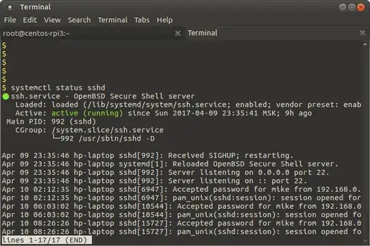

Since you have already successfully logged in to another computer on your network, you can simply copy your files to your local machine from there, but you're going to need to get an ssh deamon running on your local machine. So, install it first:
$ sudo apt-get install openssh-server -y
Make sure that it's up and running (the green light thing shows that it is):
$ systemctl status sshd

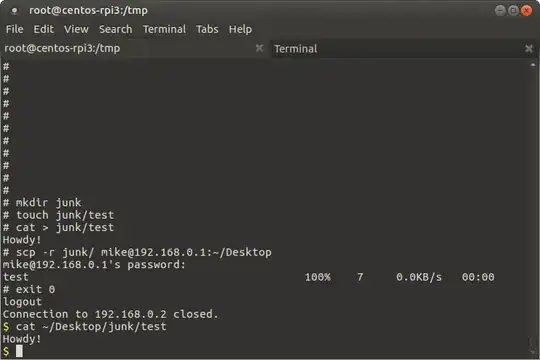

Put all the files on the remote machine that you want to copy over to your local computer in a separate directory. Then, use this command:
$ scp -r [DIRECTORY] [USER]@[IP_ADDRESS]:~/Downloads
-r means that the directory along with all its contents is going to be processed recursively. In simple terms, this means that it's the option you're going to use every time you want to copy a directory containing files. [DIRECTORY] is the path to that directory. [USER] is the user on your local machine. [IP_ADDRESS] is the IP address of that machine. The stuff after the : is where you want your files to be saved on your local machine. In this case, it's the Downloads folder.
This is what this process looks like in reality:
