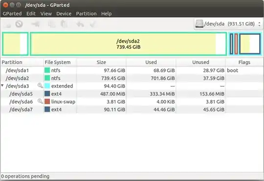

EDIT-2: Added GParted's result
GParted's result
Here /dev/sda1 is Windows primary partition (C)
/dev/sda2 is secondary (D)
/dev/sda3 is dedicated to Ubuntu
