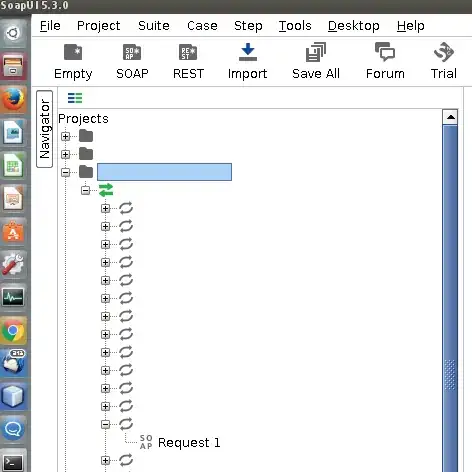

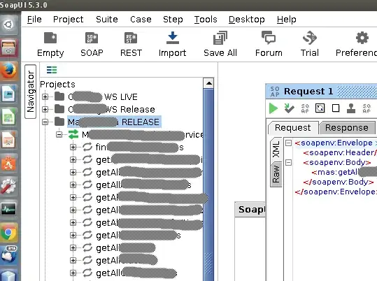

My problem is really strange and I cannot even describe it perfectly. It happened about last week after some big Ubuntu update and after I restarted the PC few days later. After the restart I realized these changes:
  • missing a lot of fonts that were previously present
    • realized when texts were displayed in strange way
  • some UI windows look like from old GTK times
  • in some UIs font is not rendered at all and accidentally appears or disappears...
GTK look-like window in unity SoapUI with missing texts SoapUI with texts OK
First I thought it might be something with wine since I had the wine-devel installed but even after uninstalling wine-devel and installing back wine1.6 the problem is not solved. Also tried to uninstall wine completely without a solution.
Some thing are minor, like these GTK looking like windows, or that some font's are gone and I have to use some not so fancy Ubuntu fonts, but the thing with SoapUI for example just makes it almost not usable...
Any idea how to solve the problem?

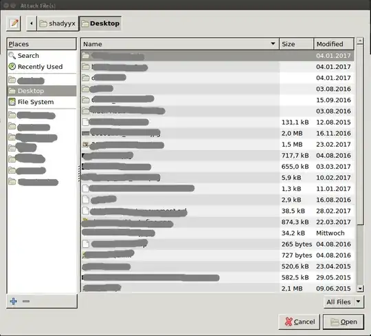

EDIT:
I still think it's wine, because when using file upload form, the UI looks like on the first picture, and then the filled in file path is like C:\fakepath\[Filename], i.e. if I am uploading a file /home/shadyyx/Desktop/picture.png, the file path in the file upload input field is shown like C:\fakepath\picture.png (correct file is uploaded, so no functional impact).
shadyyx
  • 173
OK, so I have fixed my problem. I tried to reinstall unity using
sudo apt-get install --reinstall ubuntu-desktop
which only downloaded 3k of bytes and after the sudo reboot the problems are apparently gone.
After restart I also got a warning about the mscore ttf font installer and after trying to fix this as well it seems everything is back to normal...
I am almost convinced wine broke something (especially after upgrade from stable win 1.6 to devel wine 2.1).
I hope this helps somebody trying the same wine upgrade and struggling with similar issues afterwards...
