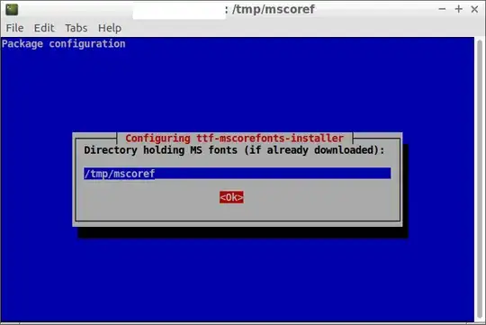

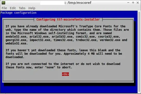

and finally:
sudo dpkg-reconfigure ttf-mscorefonts-installer
this will lead to this message:
Press enter; type the path to the downloaded files in the box (note: . does not work for me here):
and press enter again.
Now the fonts get installed smoothly:
