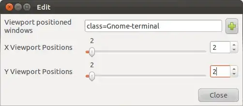

  3. Under Windows with fixed viewport click on new
    • class=NameOfYourProgram (Here the spelling is important. Better use the green plus sign and "Grab" this parameter in the resulting window)
    • Position : {1,1}top left; {1,2}bottom left, ...
    • example opens Gnome-terminal in bottom right workspace : enter image description here
