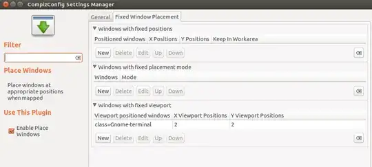

2-- Even if you want to fix your terminal at some other workspace permanently, you can do it through CCSM(Compiz) => window management=> Place window=> Fixed window parchment=> Fixed Window Viewport
You can choose the workspace by changing 'X Viewport position and Y Viewport Position'

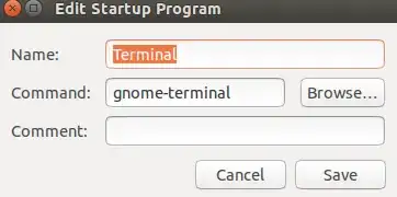

Next you would like to add terminal in the start-up applications. So that you don't have to start it by yourself This can be done easily through
In Dash --search Startup applications => Add
