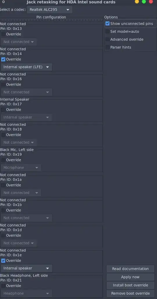

I purchased a late 2017 Spectre X360, model 13-ae013dx. I was able to solve this bug consistently using HDAJackRetask under Antergos by performing the following:
  • Override pin 0x14 and set it to Internal Speaker (LFE). I believe this enables the amplifier that drives the top speakers. Setting it to something other than just "Internal Speaker" is important, so that pulseaudio does not try to redirect sound to that channel.
  • Override pin 0x1e and set them to "Internal Speaker".
Hit Apply Now, and voila you have sound out of all four speakers.
Config screenshot:
I'm currently running Kernel 4.20.10-arch1-1-ARCH, and I have tried absolutely everything on this thread to no avail. Hope this helps!

I'm running Ubuntu 20.04.4 on a HP ENVY 16-inch laptop that I purchased in August 2022. @Juan P.'s answer worked for me. However, I had to use the exact same settings they had in their screenshot, and not only the ones they mentioned in the text of their answer. I've typed out these settings here in case the screenshot in their answer is no longer available.
To summarize, the steps for fixing the Bang & Olufsen speakers is as follows:
  1. Open a terminal window.
  2. Run sudo apt-get install alsa-tools alsa-tools-gui.
  3. Run hdajackretask.
  4. At the "Select a codec" drop-down list, choose Realtek ALC245.
  5. On the right-hand side of the hdajackretask window, click on the checkbox "Show unconnected pins".
  6. For each pin, you will either have to click the "Override" checkbox and then change the configuration using the drop-down list, or leave the pin alone if the right configuration is already set. If there is a pin ID in the table below that you do not see, skip it. Here are the configurations that you should have for each pin:
Pin name Pin ID Drop-down list option
Not connected 0x12 Not connected
Not connected 0x13 Not connected
Not connected 0x14 Internal speaker (LFE)
Not connected 0x16 Not connected
Internal Speaker 0x17 Internal speaker
Not connected 0x18 Not connected
Black Mic, Left side 0x19 Microphone
Not connected 0x1a Not connected
Not connected 0x1b Not connected
Not connected 0x1d Not connected
Not connected 0x1e Internal speaker
Black Headphone, Left side 0x21 Headphone
  1. Finally, click on "Install boot override" and then reboot. Sound should now work.
