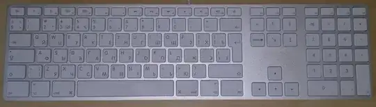

I am using Ubuntu 16.04 LTS, with an Apple slim aluminium keyboard. It looks like this (please ignore the fact that it also has Russian keys in the lower right corners of each key!):

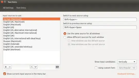

I am having problems finding the correct key-mapping within the settings. Here are the ones I have tried out so far (listed in screen-shot):

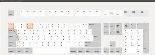

The main things I am looking at to notice that they are not the correct mappings are the positions of the back-ticks and the hash symbol. The arrow shows where the back-tick should be:

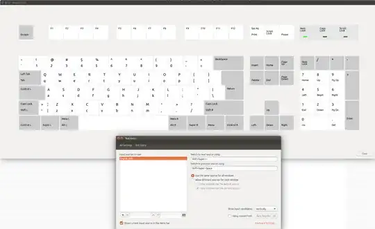

screen-shot below of the key-mapping and settings when everything is working as expected, even though the image of the keyboard is incorrect. If I hit shift-3 I get a #, and the back-ticks are being processed from the key highlighted above (one left from the z on my keyboard).
