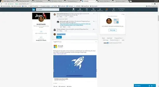

On my brand new Dell XPS 13 9360 Developer edition, there is a glitch on my screen. I might be chrome specific, but I'm unsure.
There are only a couple of lines of and moving the mouse through them typically clears the glitch.
I've already disable hardware acceleration for Chrome (which was causing flickering), but this issue remains.
screenshot 1 screenshot 2
