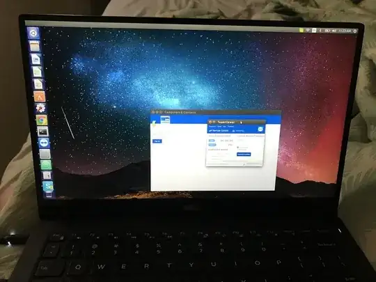

I've installed two programs (teamviewer and filezilla) so far that the resolution is just too small. How can I fix this? Picture below shows what I'm talking about.
Ubuntu 14.04 LTS on a Dell XPS 13.
My issue is only happening on certain programs -> teamviewer and filezilla so far. Everything else is the correct size. The post that was linked looks to be for a system wide issue for all programs.
Usually, reducing the display resolution makes all items appear larger. There is also the "Scale for menu and title bars" index that can be adjusted. This option is located in "System settings/Displays" under the resolution bar. Hope that's useful, it works for me...
