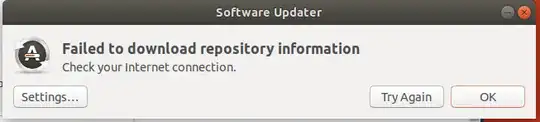

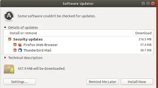

Ubuntu 18.04 For some time now the graphical GUI Software Updater would report
Then click ok would give me
Then click Install Now
it would report loading for a fraction of a second then close. I should have been suspicious, but ...

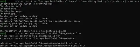

Installation instructions
Run it in the terminal
curl -s `https://packagecloud.io/install/repositories/shiftkey/desktop/script.deb.sh | sudo bash`
Alternative option. This is the command that will automatically find and add the necessary security keys of the connected repositories:
sudo apt-key adv --recv-keys --keyserver keyserver.ubuntu.com `sudo apt-get update 2>&1 | grep -o '[0-9A-Z]\{16\}$' | xargs`
Johan Palych
  • 1,401
If you look at the repository's webpage (https://packagecloud.io/shiftkey/desktop/), you'll find a button that leads you to the "Debian Installation Instructions" which tell you to download a script and execute it. Said script will pull the required GPG key from https://packagecloud.io/shiftkey/desktop/gpgkey and feed it into apt-key. Alternatively, look at https://github.com/shiftkey/desktop/#user-content-debianubuntu-distributions which lists the detailed manual steps.
