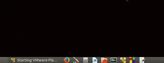

I have been using VMware Player for a long time on 14.04. I updated to 16.04 about 3 months ago. Now I am trying to launch VMware Player for the first time since the upgrade, and it refuses to launch! I double click the shortcut on my launcher, then the program tries to launch as usual by appeaing in the bottom taskbar with a message "Starting VMware Player", and after a few seconds it simply disappears with no error!

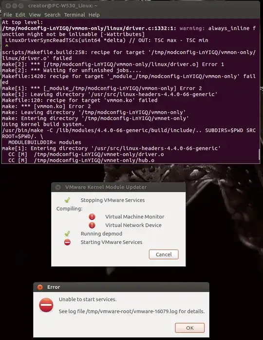

  1. I found this post VMware won't work after Ubuntu Upgrade. I ran export LD_LIBRARY_PATH=/usr/lib/vmware/lib/libglibmm-2.4.so.1/:$LD_LIBRARY_PATH and it looked like it was about to start... i was asked to update the kernel, I enter the password enter image description here
    and the process fails with this message:

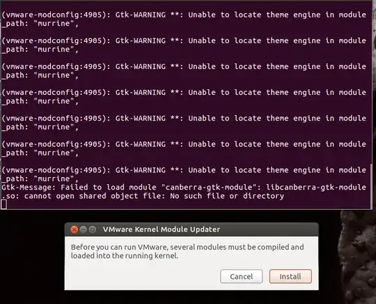

    (vmware-gksu:4905): Gtk-WARNING **: Unable to locate theme engine in module_path: "murrine",
    Gtk-Message: Failed to load module "canberra-gtk-module"
  2. using the comments in vmware player on ubuntu 15.10 I ran echo /usr/lib/vmware/lib/libglibmm-2.4.so.1 | sudo tee -a /etc/ld.so.conf.d/LD_LIBRARY_PATH.conf and sudo ldconfig. Also I ran sudo apt-get install libcanberra-gtk*
after trying all those commands, when I type vmplayer at the terminal I am asked for a password to compile the kernel, and once that process launches it fails. Image below gives you a gist of what I am seeing.
