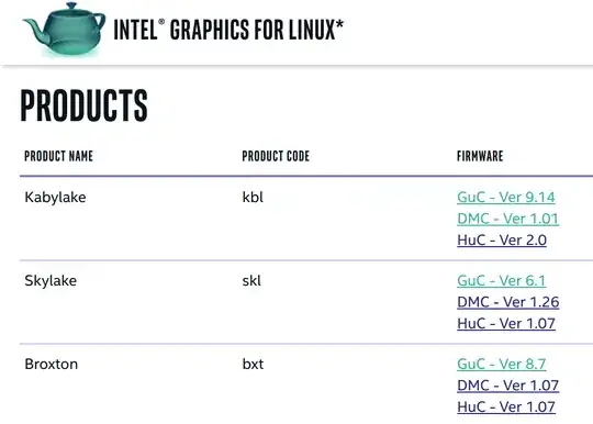

Notice how you are missing kbl_guc_ver9_14.bin. To get the missing drivers go to https://01.org/linuxgraphics/downloads/firmware where you will see this screen:
Intel Graphics for Linux AU bounty
For complete download and installation instructions see Updated kernel to 4.8 now missing firmware warnings
