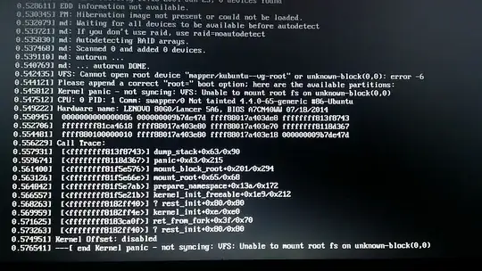

Screenshot of error: enter image description here

It seems someone has been able to solve this issue here
Kernel Panic - not syncing: VFS: Unable to mount root fs on unknown-block(0,0)
They suggest running
sudo update-initramfs -u -k $(uname -r)
Then
sudo update-grub
