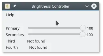

The brightness controller mentioned before is now version 2. The original simple version is available using the following steps with support for up to 4 monitors. Tested working without issue on Ubuntu 14.04 and 16.04.
sudo add-apt-repository ppa:apandada1/brightness-controller
sudo apt-get update
sudo apt-get install brightness-controller-simple
Enjoy!

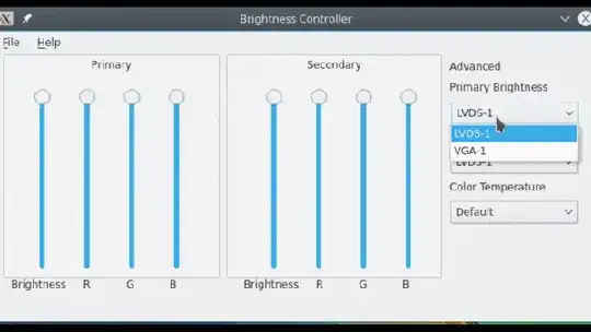

I have finally found a package, which adjust the brightness of secondary external monitor, which is connected with HDMI.
The package is called Brightness Controller (version 2 with newer interface)
In order to install it, first add the PPA repository to your system and update your package list:
sudo apt update
You can then install the package as usual using apt:
sudo apt install brightness-controller
After it is installed, primary is the first screen and the secondary is the external monitor.
