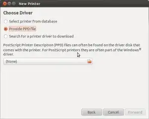

Possibly if you look at your installation disks there may be a PPD file which you can use when setting up your printer driver:
An alternative suggestion would be to connect it to a windows computer or virtual machine guest running windows and use my answer here to print to this non linux friendly printer.
