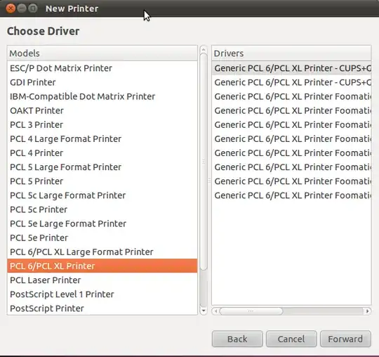

Once your unsupported printer is recognized either from USB or if setup as network printer from the appropriate network setting you are asked for a driver. If your printer is not listed you can alway select "Generic" to give you a choice of standard printing methods depicted below:
In this example on the left hand side a "PCL6/PCL XL Printer" is selceted and gives you again a variety of selections of PCL6 subsets on the right hand side. Depending on your model your Konica/Minolta printer may be a PCL6 printer and this entry may work, but you will have to simply try out what subsets are appropriate. If it's not PCL6 you may also try out if a generic GDI driver works.
Fancy special things your printer may be capable of will not work with a generic driver but at least you can print out something.
