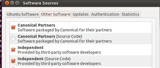

To install Adobe Acrobat you will need to enable the canonical partners repository in the Software Sources tab of Update Manager
Use Dash and search for Software Sources or Software & Updates in 13.04 and later.
If you don't see those options in Software Sources, you can use the following command from a terminal:
sudo add-apt-repository "deb http://archive.canonical.com/ $(lsb_release -sc) partner"

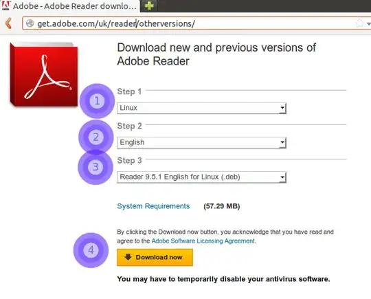

Using firefox navigate to:
Choose the following options as shown in the image - i.e. download the .deb package

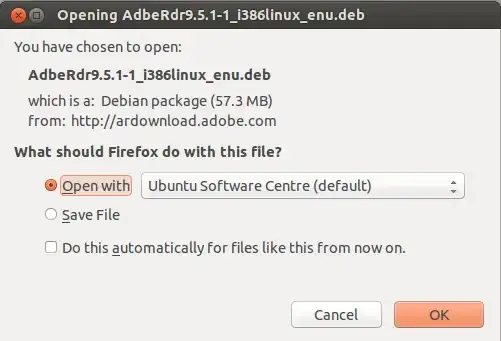

When the Download button is clicked:
Leave it at the default to open in Software Center where you can install it.
