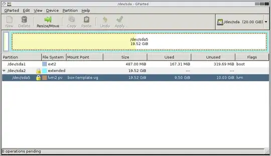

When I start up my VM booting from a GParted live CD, my "19.52 GiB" box-template-vg partition still shows "10.03 Gib" free.
VM GParted screenshot
Am I missing something important here? Or did I do something wrong when I cloned the VM and resized the drive?

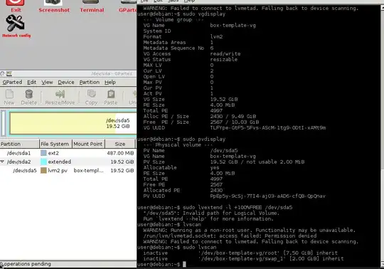

Edit: Screenshot for comment request to run lvscan:

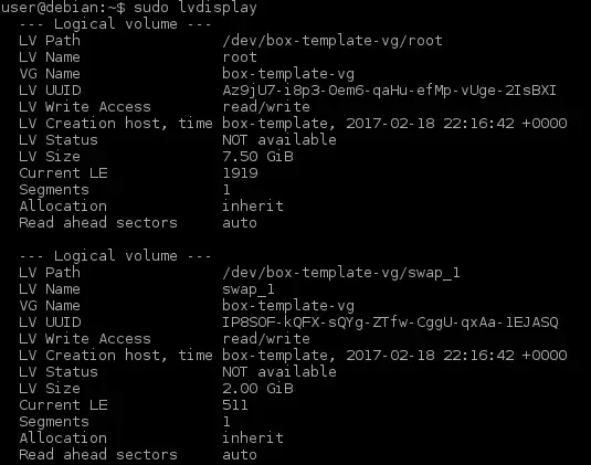

Edit 2: Including output of lvdisplay:

Edit: I just saw your output of lvdisplay. So increase this with sudo lvresize -r -l100%VG /dev/box-template-vg/root. Or, what is identical, sudo lvextend -r -l +100%FREE /dev/box-template-vg/root.

After extending the Volume Group the Logical Volume has to be extended too:
  1. Extend the logical volume with:
    sudo lvextend -l +100%FREE /dev/box-template-vg/root
  2. Run a file system check first to make sure all is well after extension:
    sudo e2fsck -f /dev/box-template-vg/root
  3. Expand the file system to accommodate the new space:
    sudo resize2fs /dev/bpx-template-vg/root
  4. Close gparted and relaunch VM
Information:
  1. To get the path of the Logical Volume Group run:
    sudo lvscan
  2. Please activate you partitions from GParted to enable steps 2 and 3 work, if not activated.
