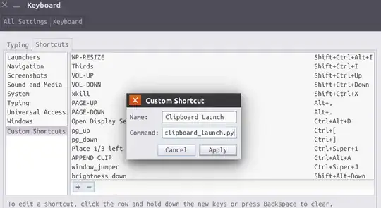

Setting up the shortcut
In both cases, you need to have script linked to a shortcut. Open System Settings -> Keyboard -> Shortcuts -> Custom. Click the + button. Give full (!) path to file as command. For example, /home/User_Name/bin/clipboard_launch.py
Assign the shortcut to be something sensible. For example, since we're calling Gimp, I've assigned my script to Ctrl+Super+G.
